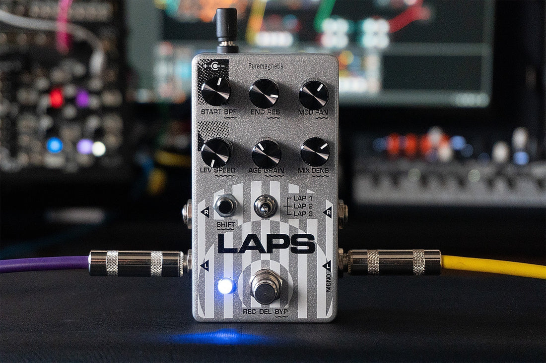

LAPS is a Daisy-powered effects pedal designed for crafting intricate layers of sounds. It was developed by Micah Frank of Puremagnetik and can record the input audio into 3 separate tracks (referred to as laps), with each lap allowing up to 20 seconds of stereo recording at 24-bit/48kHz. What we love about this pedal is how it allows artists to instantly start transforming their musical ideas into immersive soundscapes that they can explore!

Upon receiving his first Seed in November 2023, he familiarized himself with it by building a looper. However, he found that looper to be uninteresting in itself, so he looked at the Puremagnetik plugin catalog for inspiration. He decided that a hardware version of Small Winters would make an amazing hardware device for both on stage and in the studio. Made in collaboration with sound artist Taylor Deupree, LAPS's core idea—the three individually controlled loops—can be found here.
With this new direction in sight, he began putting together the breadboard by adding basic functions such as looper controls, modulation controls, and true bypass relays. After several iterations over the following months, he finalized a hardware version he was satisfied with in May 2024. At this stage, he asked Puremagnetik artist John Whitlock to design the enclosure.
After finalizing the code for his first working prototype, he once again collaborated with Taylor on a project. He sent the pedal to him for feedback and to bounce ideas around and tinkered with the algorithm for another month. He also collaborated with several community members from Taylor’s 12k Discord channel after they bought the first version of LAPS and provided feedback. Upon addressing their suggestions regarding filters, mode handling, etc., he was able to provide them with the final version of the firmware. It was exactly one year between receiving his Seed and sending out his first LAPS unit!
